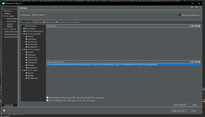

I have a project created with CubeMX v6.8.0 and HAL L4 v1.17.2. Using Windows 10 x64
Today I wanted to update it using CubeMX v6.9.2 and HAL L4 v1.18.0, and when regenerating, CubeMX wiped the linker settings "Library search path". I remember this happenning earlier too

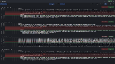

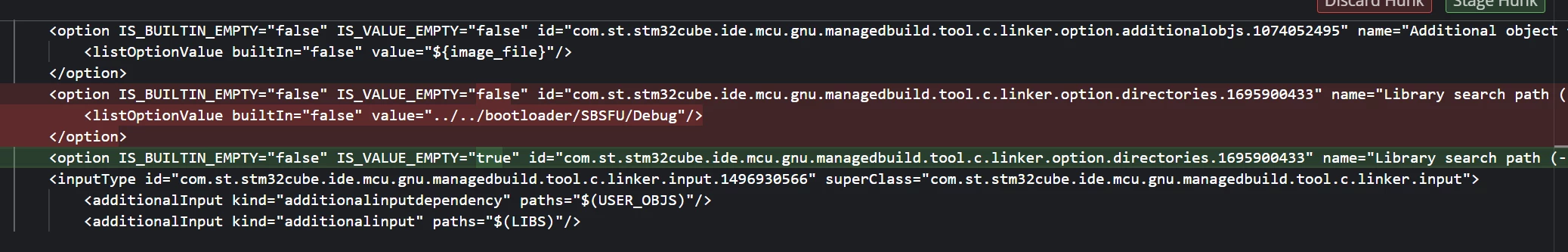

Here's the diff from .cproject file after regeneration.

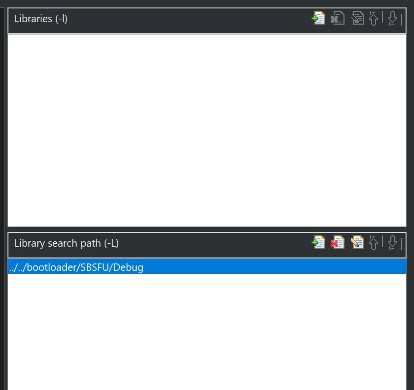

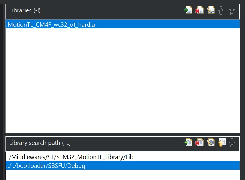

UPD: found out it only happens if there are no libraries in the include list
This config gets regenerated okay (from another project):
And this config gets library search path wiped on regeneration
I need the library search path to include extra linker scripts located elsewhere

I tried to reproduce your request. In fact, I have created a project using CubeMX v6.8.0 and CubeIDE 12.0.
Then I added the link of the library indicated in the screenshot.
I made the migration to CubeMX 6.9.2 and I generated the code to CubeIDE 13.2, but the problem is not reproduced and there is no loss of the library path.
