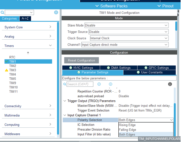

In certain STM32 MCUs input capture can be defined for both falling and rising edge.
0693W00000DmC0uQAF.pngIn such cases, how to know if the input capture interrupt routine was called due to a falling or a rising edge? Is there a way to know?
1 REPLY 1
waclawek.jan
There's no direct way.
But you can simply read the current state of given pin from respective GPIO_IDR, If you know that the input signal won't change too fast.
