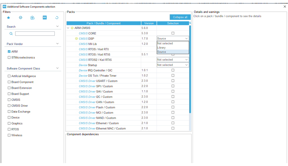

I have another answer that worked for me. Go to the "Addition Software" link on the .ioc. Then filter for ARM CMSIS

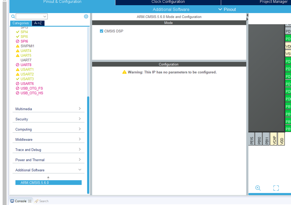

Install this SW package and you will then see an option in the configuration to turn on DSP functions:

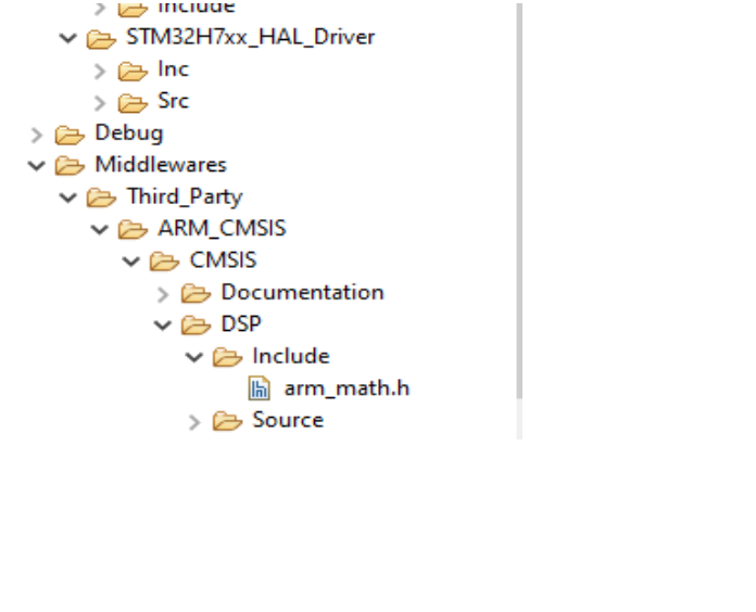

Enable this and regenerate the code. You will then have a new folder in your project titled "Middleware". Dig down deep and you will find the arm_math.h include:
This solved the problem. Also make sure to include the required arm math source files into the main Src folder. You can get these from the DSP Source mentioned in the above diagram.
