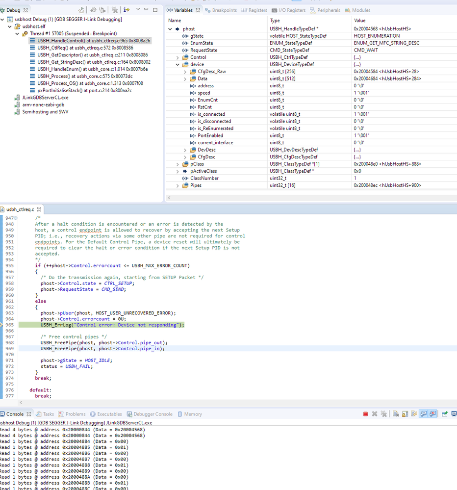

Here is a screenshot of a breakpoint including caller stack and variable view

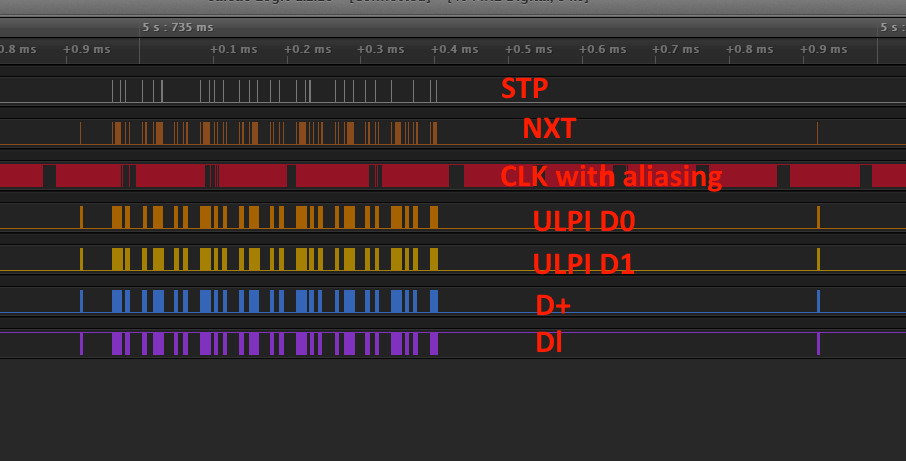

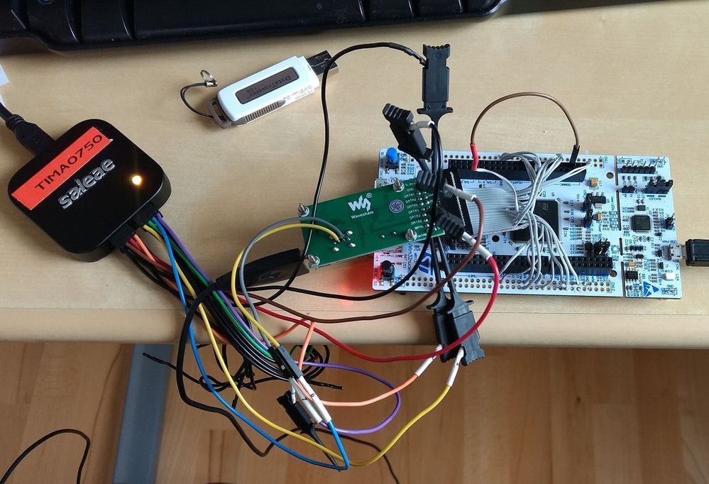

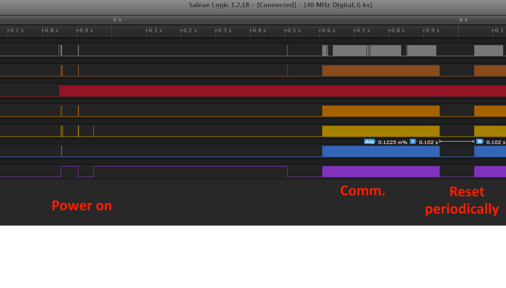

I tried to use an eight channel logics analyzer (Saleae Logics) which is way too slow to handle the 60 Mhz Clock output or the 2.0 data lines (480 Mhz).
But I see signals and the reset behaviour
A closer look into the communication with the signal names.
It shows maybe the communication of the vendor and devide ID.

I would be surprised if those 60MHz signals you can't capture with your LA would work properly over a bird's best of flying leads. Even if you'd use a proper return/ground for each signal - which I doubt you do.
