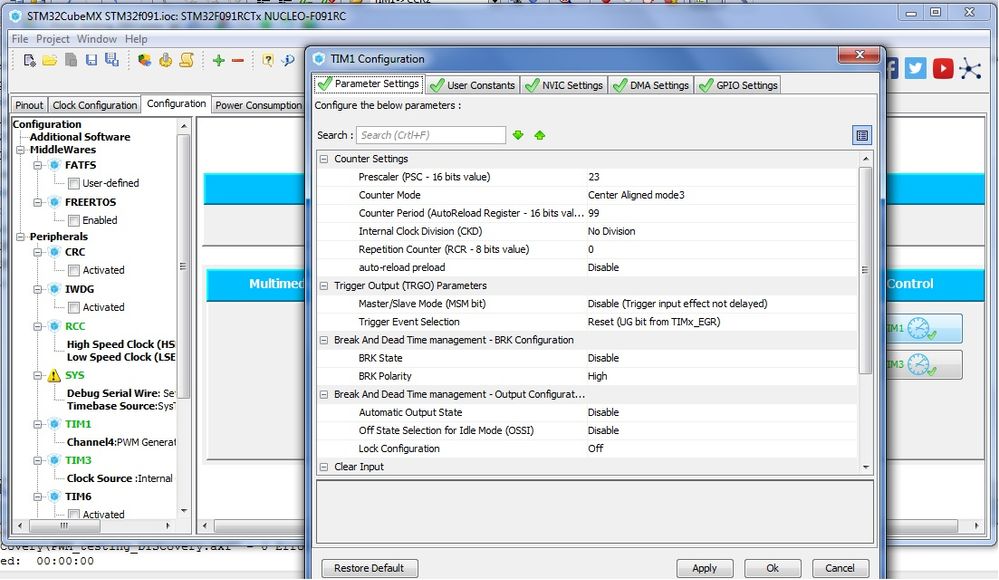

I want to generate center aligned pwm in stm32f030k6tx but when i am chosing the option of  center aligned in counter mode than it is converting it in edge aligned mode.So can any help me in how to generate central aligned pwm.

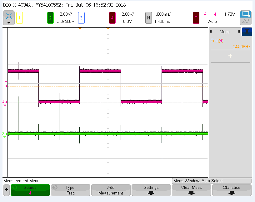

I have generated a project using STM32CubeMX tool (Used HW: STM32F030R8T6 on a Nucleo boad): PWM in center aligned mode on pin PA8 + I have toggled the PB1 pin at each update event (CNT = ARR & XNT = 0) in order to be sure that the center aligned mode is correctly generated.
Below is a screenshot of the result:
If you still encounter the problem, you may share your ioc file and I will check it.
