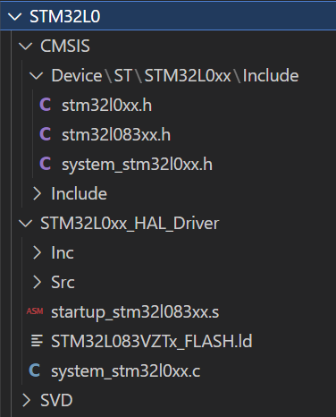

Is it copied to the project's structure, but the structure that I have looks like this:
Screenshot 2024-02-23 100221.pngSo the path to the FW version (e.g. STM32Cube_FW_L0_V1.12.2) is missing.

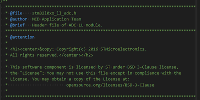

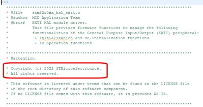

The file headers have a copyright year; eg,
I guess you could use that to narrow down a set of firmware pack versions to download, and then diff to see which one matches?

Thanks for the hint!
Apparently it's from 2016:
which means it should be v1.8.0 according to the release notes.
But one of the old developers told me it should be 1.11.0.
But I will take your idea and start doing diffs around these versions. Thanks for all the help!
