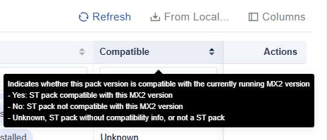

Regarding the Second point: It was decided to display all packs available on the server and only indicate their compatibility with STM32CubeMX2:
  • Yes: ST pack compatible with this MX2 version
  • No: ST pack not compatible with this MX2 version
  • Unknown: ST pack without compatibility info, or not an ST pack
Note: Any displayed pack can still be installed, even if it is not compatible.
