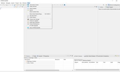

The problem is that the menu option "Manage embedded packages" is missing:
I checked this on two computers with Windows 10.
During the installation, there were no error messages.
What can be done about this?

Hello @xx111
STM32CubeMX 6.17.0 is no longer integrated into STM32CubeIDE 2.1.1. Instead, the two tools are now interoperable.

xx111
But does that mean I don't necessarily have to install packages in CubeIDE?
I'm talking about packages like STM32CubeU5.
It seemed logical for me that since the libraries contain Low-Layer APIs and CMSIS, they would be more needed by  CubeIDE than by MX.
But I see that I was mistaken.
Yes: the packages are used by CubeMX - not directly by CubeIDE.
CubeIDE deals only with source files - it neither knows nor cares whether they came from ST (as a "Pack", via CubeMX), or from the user.
