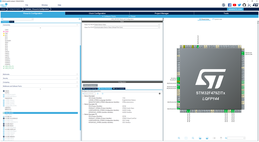

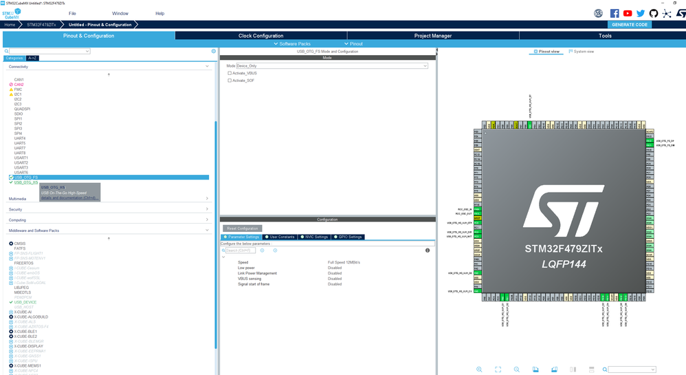

To create a USB composite device with CDC and UAC functionality, you can follow these general steps:
1- Select your target microcontroller model (e.g., STM32F479ZITx)
2- Enable the USB_OTG_FS and USB_OTG_HS by navigating to the "Connectivity" tab .
_legacyfs_online_stmicro_images_0693W00000dDTgsQAG.png3- In the "Class For FS IP" section, select "Communication Device Class (Virtual Port)" to enable CDC functionality.
In the "Class For HS IP" section, select "Audio Class" to enable UAC functionality.
_legacyfs_online_stmicro_images_0693W00000dDToRQAW.png4- Configure the other settings, such as endpoints, buffer sizes, and callbacks, as needed for your application.
5- Configure the clock settings and other peripheral configurations as per your project requirements.
6- Generate the initialization code using STM32CubeMX and export the project for your chosen toolchain (e.g., STM32CubeIDE).

I would like to use the STM32F4 USB FS device as a composite device(UAC+ CDC), without using a USB HS device.please let us know how to implement it.Thank you。

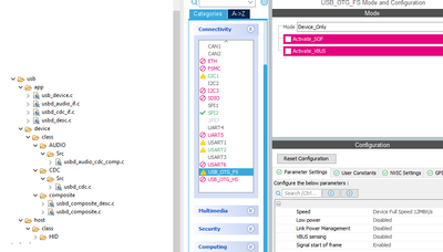

it is a shame that CubeMX does not support a combination of several device classes. After one day of searching examples i found a "software pack" for CubeMX:
alambe94/I-CUBE-USBD-Composite: Create STM32 USB Composite devices with ease. (github.com)
ST, please support this project and promote it, so we all can save lifetime!

Isn't the I-Cube composite plug-in fantastic!  I also passed it to STM's Paris support manager, Cedric, saying this was an example of what was needed, but the response was null, not interested.
