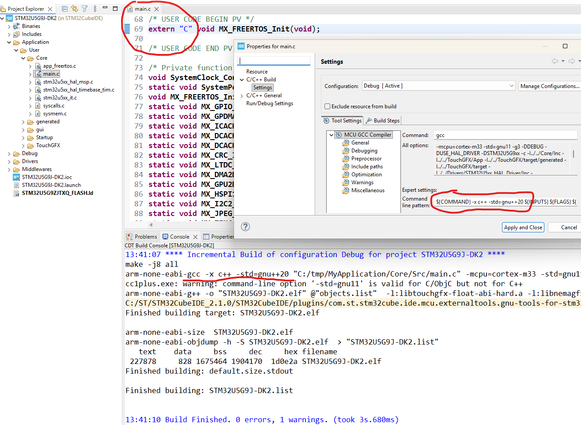

try to use "-x c++" with .c files you want to compile as c++.
