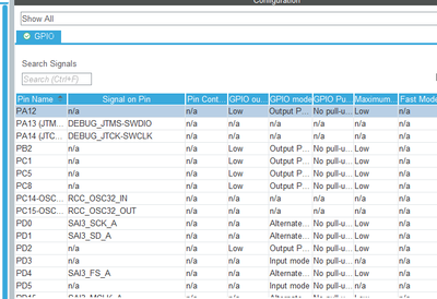

I have a question while configuring the GPIO on stm32cubeMX. I put all my pins in the program like this:
When I configure all the pins and generate the code, not all the configured pins appear in the gpio.c file on stm32cubeIDE; for example, the UART RX and TX pins do not appear in stm32cubeIDE.
Thank you so much.
Because they are used as UART RX & TX - rather than just as GPIOs ?
Have you looked in the UART config?
EDIT:
See the HAL_UART_MspInit() in your usart.c; also look in main.h ...
EDIT:
rubenlesAuthor
Feb 5, 2024 6:32 AM UTC
@Andrew Neil UART config was there, true, thank you so much for this advice!!! Other gpio still doesn't appear, but uart is solved thank you!!

Normally, pins are initialized in stm32h7xx_hal_msp.c for most peripherals.

Feb 5, 2024 6:33 AM UTC
@TDK This file is empty for me, just one interrupt configuration is in there
 __HAL_RCC_SYSCFG_CLK_ENABLE();
 /* System interrupt init*/
 /* PendSV_IRQn interrupt configuration */
 HAL_NVIC_SetPriority(PendSV_IRQn, 15, 0);
But nothing about gpio configs.
