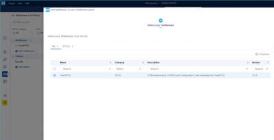

There is no USBX or other middleware in my cubemx2, but the connection introduction indicates that it is available.

For the first release of the Embedded Software for C5 the FileX, LevelX, USBX, and LwIP is unfortunately not supported by STM32CubeMX2, but a the support is planned to come latest early Q3 this year.
For inspiration for using USBx there are still available example that you can find here: https://dev.st.com/stm32-example-library/result?filters=N4IgpgHghgtgDgGzAOVmEAuA2gXQDQgwDGArprgQEYD2UATgCbn6ECWDDSA7vetiAFUAygCEAGiBbESAETqsAbmDrMqtRgAUoRANZQA5nwogG8pXQAqATzhGcAXyA
