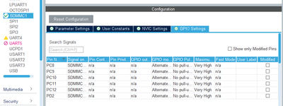

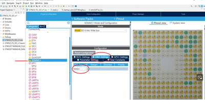

I would like to have advice, I see this video about SD Card :
https://www.youtube.com/watch?v=I9KDN1o6924&t=359s
And in the video (5:30) I can see DMA tab via CubeMX
But with me I don't have this tab, do you know why ?
I have STM32L552E-EV Evaluation Board with STM32L552ZET6QU microcontroller, after me It's possible to have the DMA with SD Card.

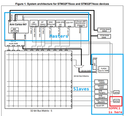

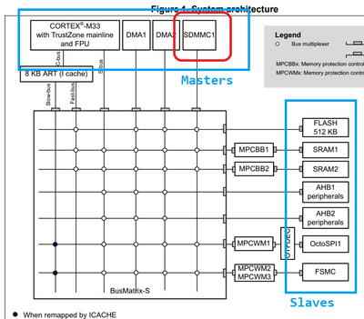

‎2025-01-10 7:24 AM

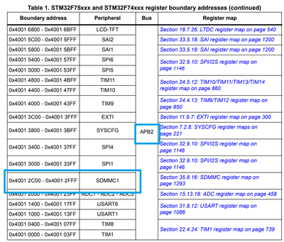

There is no DMA configuration for the SDMMC on L5 as it's already a master (a kind of DMA):
Unlike the F7 family, SDMMC1 is mounted as a slave on APB2 where you can configure a DMA (a master) for DMA transfer:

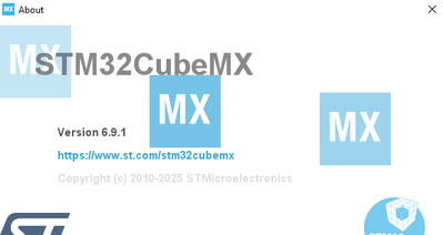

‎2025-01-10 7:30 AM - edited ‎2025-01-10 7:31 AM
Thank you for this information, does this mean by default I am already in DMA with my STM32L5xx card ? Right ? For CubeMX I have this version
