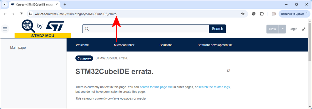

That link doesn't work:
There's a spurious full stop on the end.
The previous link to the same page is OK.
christelle burguera
November 28, 2024
hi Andrew,
The extra character in the url was suppressed.
Thank you for telling us
