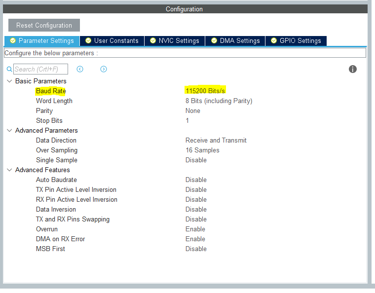

- Open CubeMX
- Activate USART or UART or LPUART or I2C or SPI (IPs communication)
- Change the value of the baud rate
![0690X000008AlVOQA0.png 0690X000008AlVOQA0.png](/t5/image/serverpage/image-id/38629i018F9070718DD68E/image-size/large?v=v2&px=999)

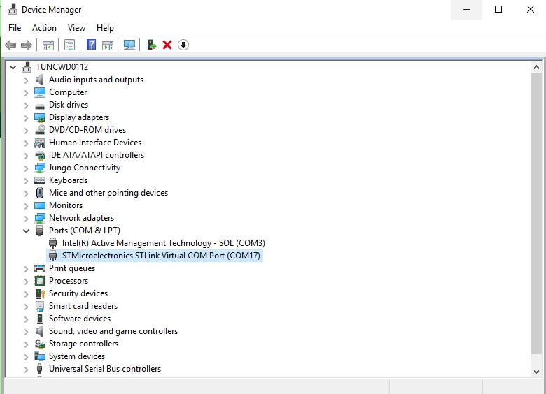

- Go to Device Manager
![0690X000008AlViQAK.png 0690X000008AlViQAK.png](/t5/image/serverpage/image-id/38632iFEB5A518009CD326/image-size/large?v=v2&px=999)

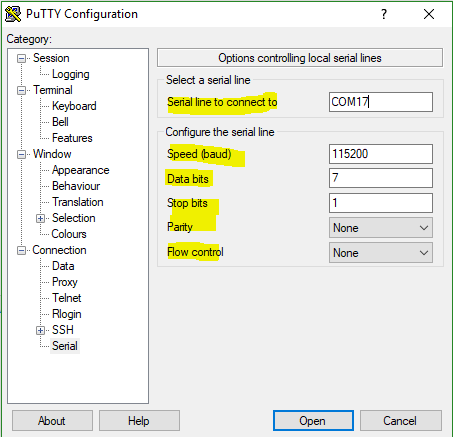

- Open PuTTY => Putty configuration : put the same configuration of CubeMX: Speed, data bits, stop bits, parity and flow control.
![0690X000008AlVxQAK.png 0690X000008AlVxQAK.png](/t5/image/serverpage/image-id/38630i118F4A9FEF3F411B/image-size/large?v=v2&px=999)

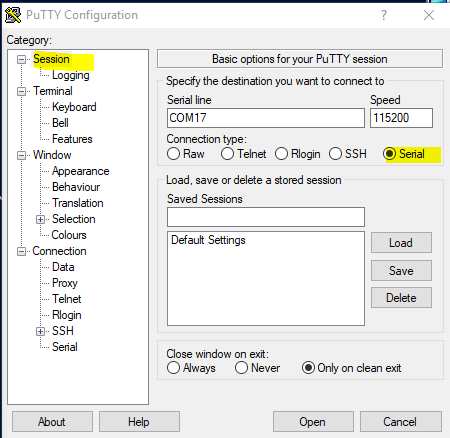

- Go to session => Connection type: Serial
![0690X000008AlWWQA0.png 0690X000008AlWWQA0.png](/t5/image/serverpage/image-id/38631i77B23B82B5389CCF/image-size/large?v=v2&px=999)

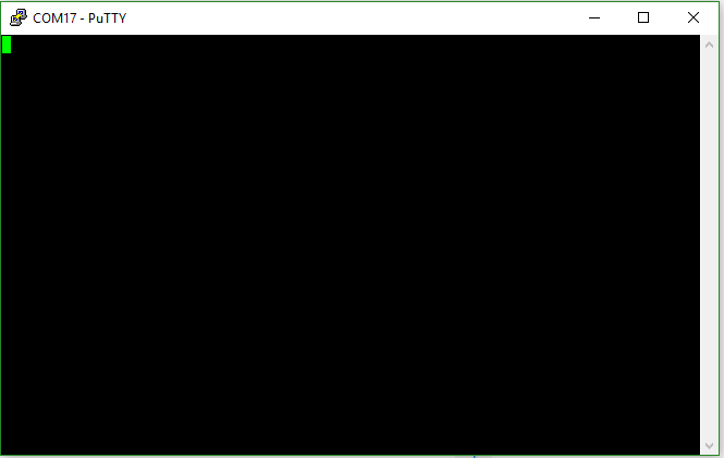

- Click Open=> a black window starts
![0690X000008AlWgQAK.png 0690X000008AlWgQAK.png](/t5/image/serverpage/image-id/38633i2A8EA6FD5A0396EE/image-size/large?v=v2&px=999)
