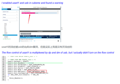

我在cubemx中同时使能usart1和usb发现有个警告
I enabled usart1 and usb in cubemx and found a warning

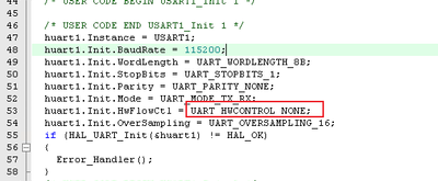

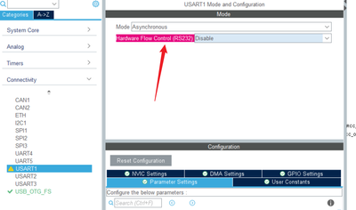

usart1的流控被usb的dp和dm复用,但是实际上我是没有开流控的
The flow control of usart1 is multiplexed by dp and dm of usb, but I actually didn't turn on the flow control

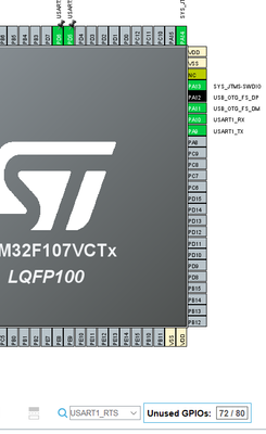

Doing the exercise, unfortunately there is no available CTS/RTS pins for USART1:
The only available pins are used by the USB.

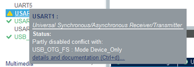

Second, mostly because there is a conflict in the pin usage especially with CTS/RTS pins that are used with USB pins. You need to pass you mouse cursor over "USART1" and you will get the warning that provides you the information about the conflict.
You can still use UART1 without HW control with USB or find another GPIOs containing these alternate functions of CTS/RTS.
