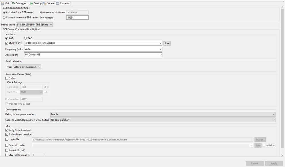

In debug configuration,

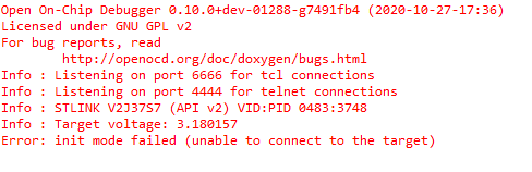

When I set debug probe to "ST-Link GDB Server", I got "Failed to start GDB server Error in initializing ST-LINK device."

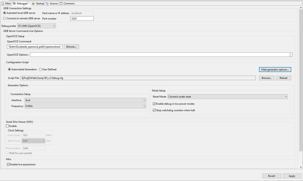

When I set debug probe to "ST-LINK (Open OCD)", I got "localhost:3333: The system tried to join a drive to a directory on a joined drive."
I programmed my board on Keilu5 without any problem. Actually I have to press reset button after flashing even I select "reset and run". this is maybe an important issue. Also, debugging on Keilu5 working bugy on my board. I hope this information bring a solution to your mind.

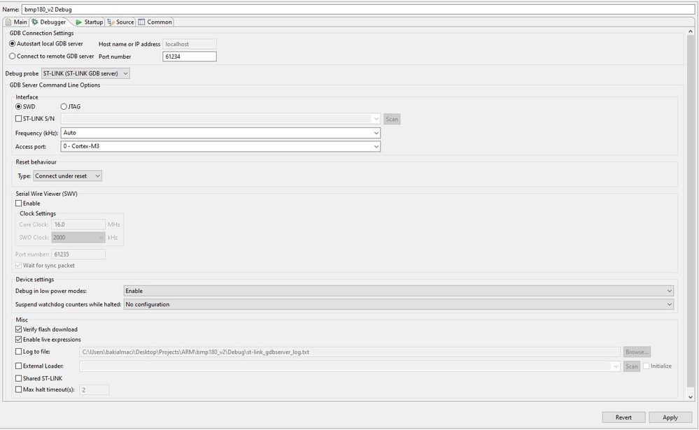

I rearranged my debug configurations like that,
0693W000007YznFQAS.jpg0693W000007YznAQAS.jpgEverything works fine!
