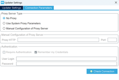

I may not be at the right place but since I can't even start on the CubeMx, here it is.
I'm a long time user of Microchip PIC product but since this is my first attempt to use the STM32 I suspect I will have some big time to understand all it's new setup. After looking several video on simple program, I downloaded the CubeMx 6.12.0 and I try those. But as soon as I try to push the blue "generate code" button at top far right, nothing happen. Same thing with the icon on top center "myST" login, nothing happen. I'd like to be able to use the STM32 board for larger and more memory space, so if someone  can help me on this one so I can move on to the programming section, that will be great.

No for MX use no board connection is required, but W7 maybe is issue. ST installs dont right check existence valid library sometimes. Try install more recent VC redist Latest supported Visual C++ Redistributable downloads | Microsoft Learn
Win7 isn't supported anymore, but that's probably not the issue. But it could be.
Are you behind a corporate firewall or something similar?
Might want to try the standalone STM32CubeMX where you can verify that your internet connection works as expected. Could also be ST's servers having issues, but no trouble here. The first time you click "generate code" it can take a while. I don't know what it's doing in the background, but it does seem to phone home.
Dany0
So the Windows update does nothing and as for the UPDATER SETTINGS when I click on "Check Connections" it seem OK. I'll try to upload some picture of the pages I have .

So for an update, I borrowed a Windows10 machine and do the same setup and now after the "Generate code" and
long downloaded time I see a new folder having that : Folder: Core
                                                                                      Folder: Drivers
                                                                                      Folder: EWARM
                                                                                     .mxProject
                                                                                     SZTM32 Sept2024.ioc
I'm still in the main page of CubeMX, but something must have been working.
So what to do next, and thanks for the reply
CubeMX is only project generator, for next step yu require choice one IDE. Open dropdown and check list, have you any of this installed ? When no for beginer choice STMCubeIDE (download and install from ST), then ofcourse generate code for it.
