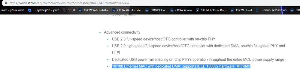

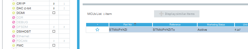

2019-04-22 1:16 AM
Something must be wrong here.
It has been taken just a second ago from your site.
Also I have a working Ethernet on this MCU, I just need the CubeMX to create a sketch of the MCU and its occupied pins.

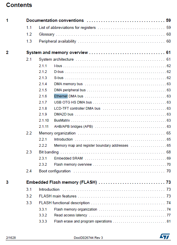

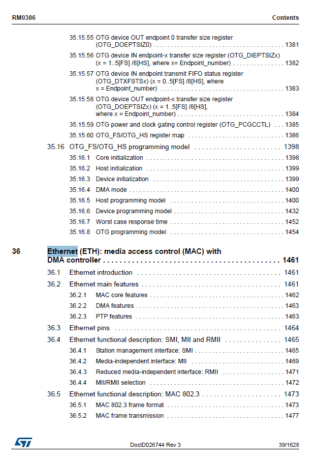

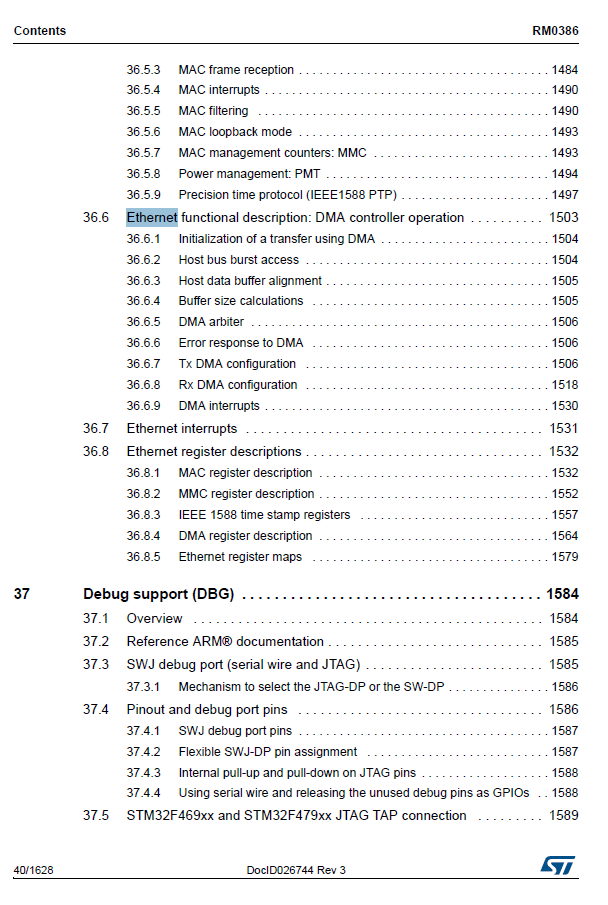

2019-04-22 2:04 AM
Also, here is a manual for it.
It does support Ethernet otherwise my Ethernet would not be working!
2019-04-22 3:00 AM
You need to select STM32F479I/B/N device, not STM32F479Z.
