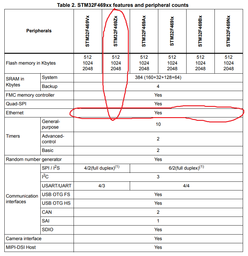

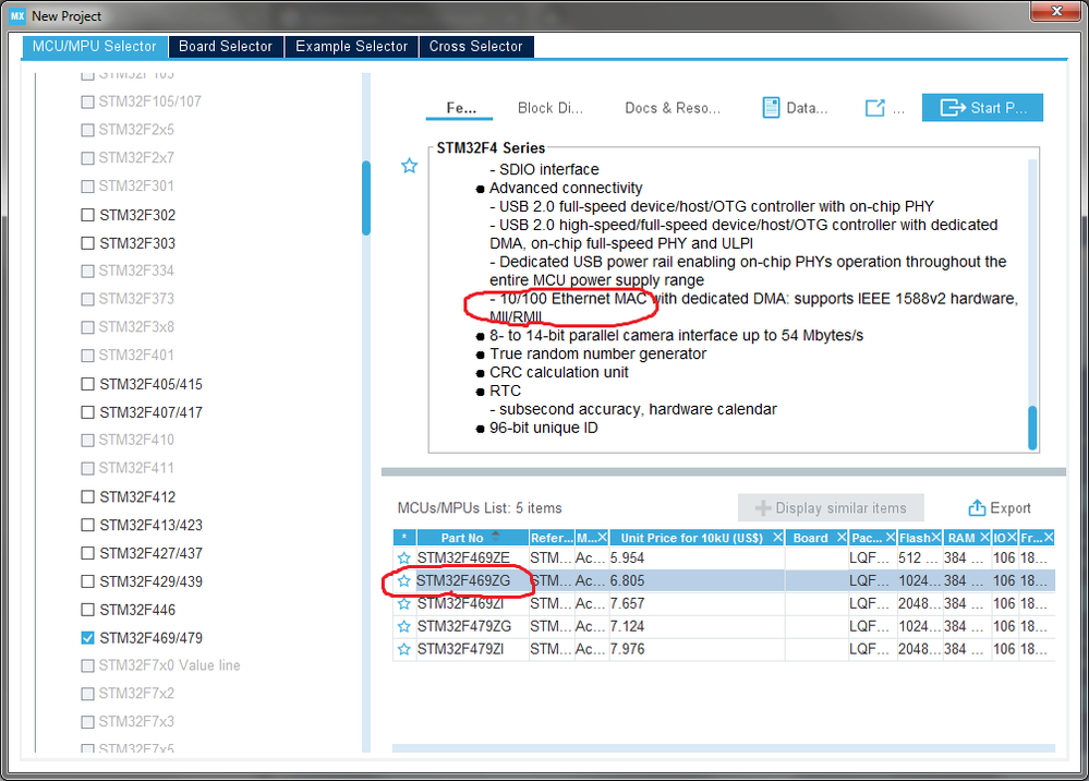

How to configure STM32F469ZxT Ethernet in CubeMX? There is no "ETH" item on "Connectivity" page. However acording to datasheet ethernet supposed to be supported.

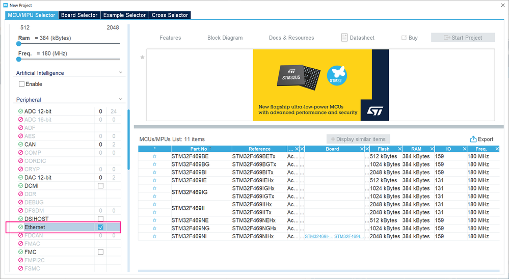

Houda GHABRI
Hi @OKoch.1​ ,
thanks for your feedback.
I will raise this issue internally to be fixed.
Meanwhile, to detect which F4 MCU contain ETH, you can do search by selecting "Ethernet" in peripheral list of MCU selector as explained in the screenshot below :

OKoch.1
Hence, STM32F469Z does not support Ethernet. Am I right? But the description of MPU features in CubeMX contains Ethernet. This is quite confusing.
Houda GHABRI
Hi @OKoch.1​ ,
Yes STM32F469ZI & STM32F479ZI/G does not support Ethernet .
The "Features" description in MCU selector is common for one MCU line (in our case STM32F469/479 ) and for this line Ethernet is supported except for STM32F469ZI & STM32F479ZI/G, that's why the description features contain Ethernet
Houda
OKoch.1

Houda GHABRI
Hello @OKoch.1​ ,
Sorry for the delay.
Yes the datasheet need to be aligned.
The configuration in STM32CubeMX is correct.
Hope this helps you.
Houda
Hi @OKoch.1​ ,
I confirm what was said by @Houda GHABRI​ . The STM32F469/F479 datasheets are already updated (see DS11189 and DS11118).
Please note that even if Ethernet is running successfully on some parts, ST cannot guarantee its full functionality on STM32F479V/Z/A.
-Amel
