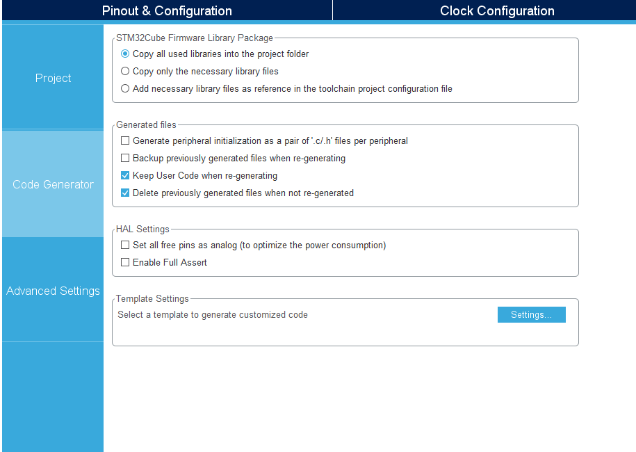

‎2019-05-13 1:18 AM
Hi @LuÃs Afonso​
It depend on what you use as STM32Cube Firmware Library Package:
If:
- Copy all used libraries into project folder ==> The DSP file will be generated (Drivers\CMSIS\DSP\Include=> arm_math.h )
- Copy only the necessary library files ==> The DSP file will not be generated
Best regards,
