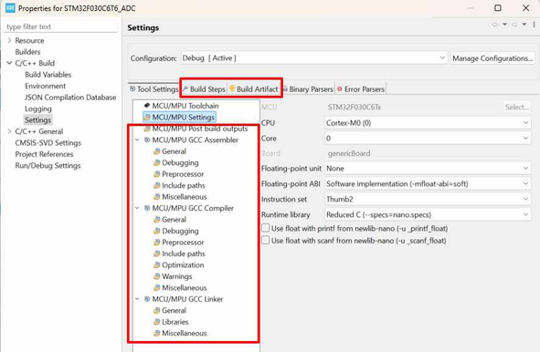

‎2025-06-19 8:03 AM
‎2025-06-19 8:08 AM

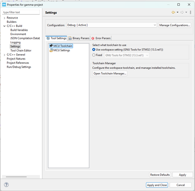

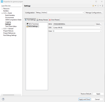

I don't have all of these options availlable. here is what I see:
‎2025-06-19 8:18 AM
Then your project is not-managed (makefile) and you have to add all needed options to your Makefile.
‎2025-06-19 8:21 AM
My project is using CMake, and builds correctly. The error seems to be coming from STM32CubeIDE error parsers, not my build configuration.
