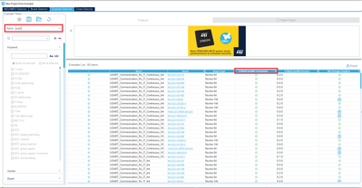

KDJEM.1
Hello @Thomas LB ,
For UART example, I recommend you to take a look to Getting started with UART wiki article.
This article explains what is UART and how to use it through examples.
These examples are configured using STM32CubeMX.
Also, I think the available USART examples compatible with STM32CubeMx can help you.
I hope this answer your request.
Kaouthar
