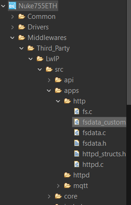

I noted one thing right away, all tutorials have the "Middleware" folder sub-divided as follows:

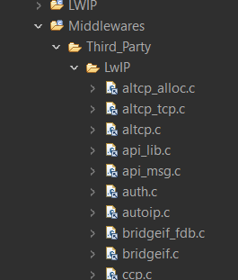

While in my case, the folder inside the M4 project is:

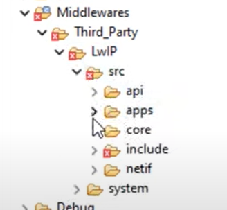

And the folder in the "main project" section is as expected:
Have you noted this behaviour already?
Is it something I got wrong in the settings?
Just so you know, if I compile with the fs files in the common section, it compiles but the web server doesn't open the expected file. If I place the fs files in the "undivided" folder, it doesn't compile at all.
Thanks in advance,
Zack
