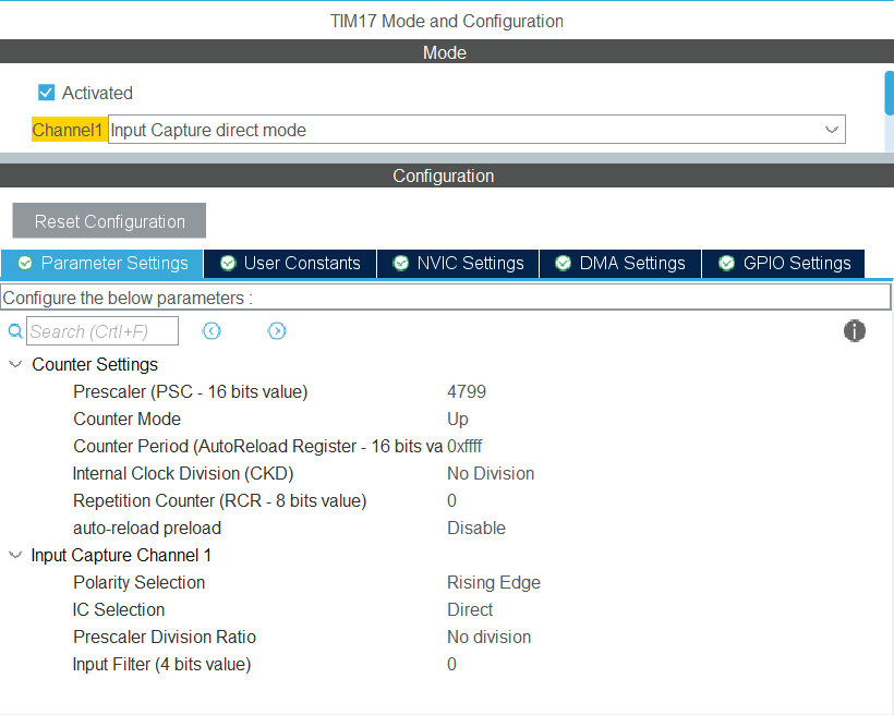

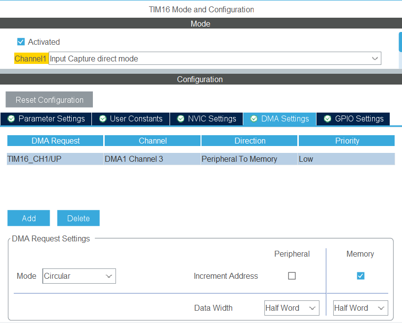

I have two Input Capture. One at channel 1 at TIM16 and one at channel 1 at TIM17.
But only TIM17 calls sevral times. TIM16 only calls one time. Then it seems that it stops.

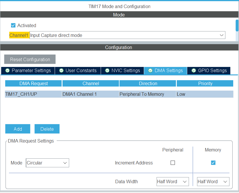

Only call one time is a sign of the DMA is in normal mode. If I can call DMA servral times, that means that the DMA is in cirular mode.
What happens:
For input_capture0 (TIM17) array, it works like a charm. Every time I pulse 3.3v onto the input, I get a different value.
But for input capture1 (TIM16) array, the function compute_frequency always return 0.153186 and the value never changes any more. No matter how much I pulse 3.3v onto the input.
Can it be that even if I have selected cirular mode for TIM16...it's still normal mode?
Because if I have normal mode on DMA for TIM17, the the same behaviour occurs, with a different value of course.
The MCU is STM32F373VBTx and STM32CubeIDE 1.7.0
My code:

Here is my setup for TIM17.
0693W00000D1pJNQAZ.png0693W00000D1pJSQAZ.pngAnd here is for TIM16.

KnarfB
Have you checked the Cube generated code and the DMA register settings at runtime?
I have generate the code bit I don't know where to look if at.​
