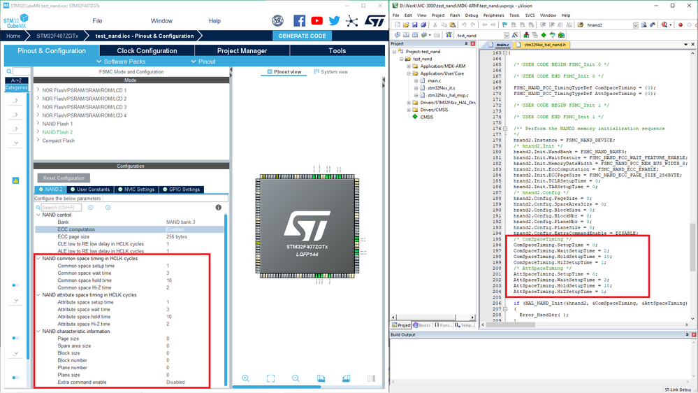

Distinguish setup CubeMx for Keil
A.Rade.96
Hello my friends, why is not generated setup from CubeMx for my Keil, why is distinguish setup ?12345678.png

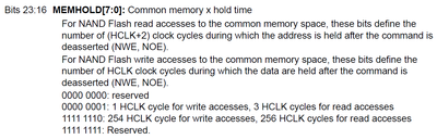

In the register fields that control these timings, a value of 0 means 1 HCLK cycle, hence the difference of 1.
Except for MEMHOLD which is the same:

Thanks a lot, this is user manual cubemx?
This is from a reference manual for the STM32F4 series.
