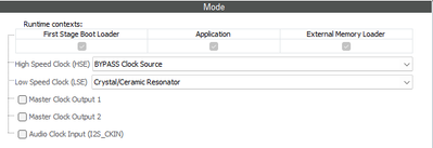

Does anyone know how to setup the clock source for the N657 processor?  I want to use an oscillator for the HS clock input and setup HSE = Bypass clock source...
using Bypass clock it should only use PH0 (clock in) and free up the PH1 pin (clock out).  But it seems the IDE / cubeMx always wants to use both pins regardless of the clock configuration.
am I missing something or is this a bug?

This issue has been resolved in the latest version of STM32CubeMX 6.17.0

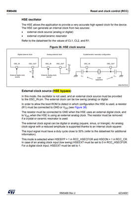

According to RM0486 Rev 2, Section 14.6.2: External clock source (HSE bypass):PH1 (OSC_OUT) is not required for HSE bypass mode.

Hello @matt-crc @AScha.3
