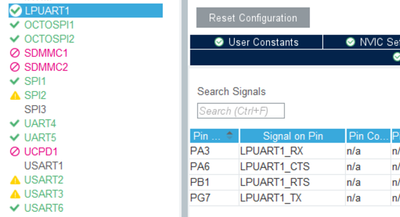

I start with LPUART1 configured as follows:

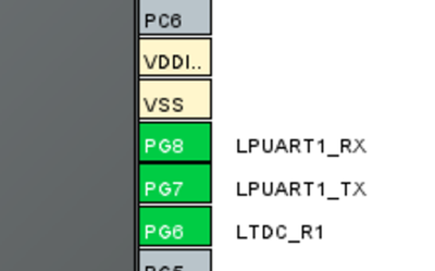

Which has pins assigned like this on the MCU:

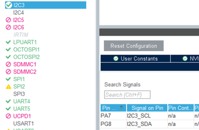

I then enable the previously disabled I2C3 peripheral - there's nothing to say it conflicts with anything.  This results in I2C3 looking like:

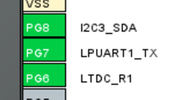

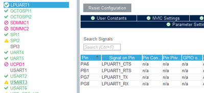

Having done this CubeMX silently reconfigured the LPUART1 pins.
thus:
So the question is: "Is this normal?" If so I've never noticed before. It seems odd to me as I could have had a physical board made with the LPUART1 pins setup in the initial config.  Adding the I2C3 peripheral breaks LPUART1.

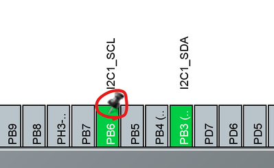

It's normal as CubeMX will try its best to find pins for every peripheral as you enable them. In this case, one of those pins was likely needed for the new peripheral.
If you don't want a pin to change, lock it (right click -> Signal Pinning or Pin Locking). Then it won't be reassigned (and may prevent some peripherals from being enabled).
