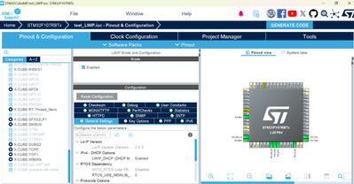

I created a project using the STM32F107 and Ethernet. Everything was setup using the .ioc template with Ethernet and various GPIO stuff. Lwip was not included. I generated the code and all of the Ethernet configuration was created. Compiling the code worked with no errors.
I have not connected my board and tried to program it as I just wanted to see if CubeIDE would generate the code properly for the STM32F107 part.
I then re-opened the .ioc file and enabled Lwip since that was my goal. Now when I generate the code, it removes all of the Ethernet setup code. This means none of the Ethernet RMII pin mapping is in place and none of the Ethernet files are in the project.
Is the STM32F107 no longer supported for Ethernet+Lwip applications? I just need a simple application with 2 buttons to control 2 relays. An STM32F7xx is overkill.

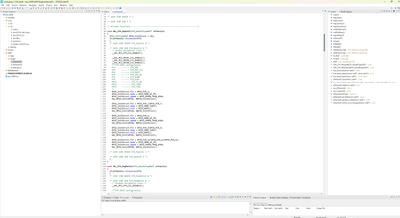

When you enable LwIP,  The RMII/MII pin configuration and initialization code is typically moved or managed within ethernetif.c rather than being in main.c  as shown in the following screenshot

Hello @Raymond Buck

Ghofrane, thanks for pointing that out. I was previously using STM32CubeIDE V 1.12.0 and just upgraded to V19.
I notice that the void MX_LWIP_Init(void) prototype is not setup and that MX_LWIP_Init() function is not being called in main.I added those and the code compiles successfully.
