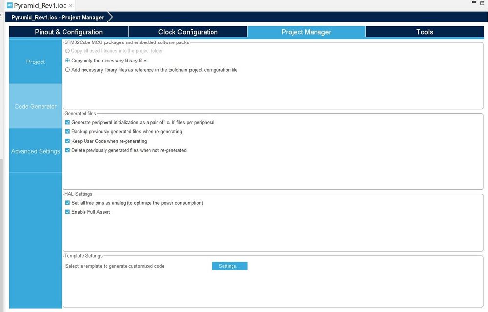

2022-10-27 5:35 AM
Hello Sara,
Yes the problem occurred first time , not sure but probably when I installed update for STMCubeIDE.
It was working fine before.
I am sending the screen shot for the code generator setting

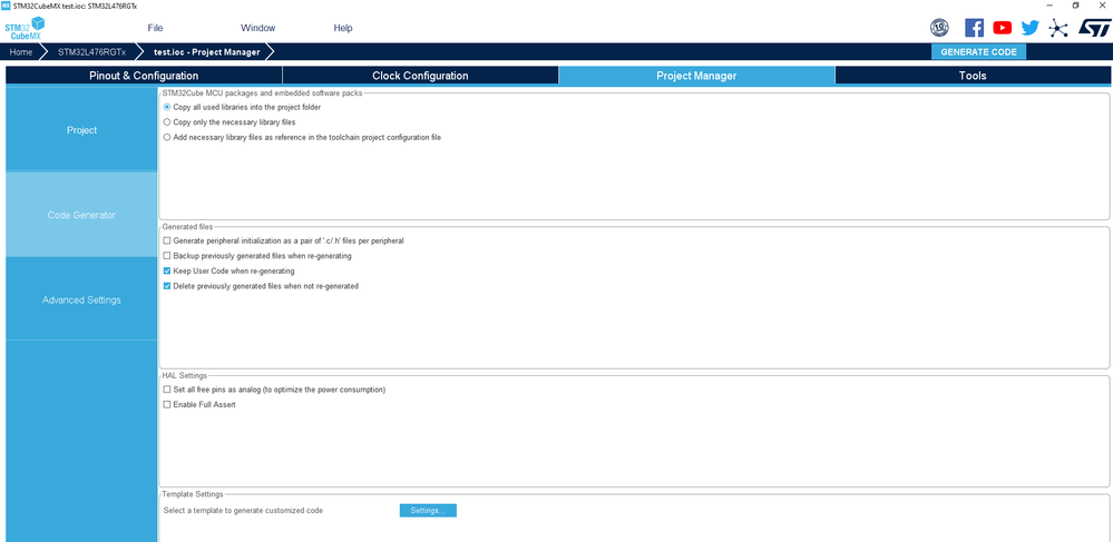

2022-10-27 6:19 AM
hello again @KKato.2
I have the same version of CubeMX (6.6.1) and CubeIDE (1.10.1) and it works fine for me!
Try to change your settings as following :
if the problem persists, maybe try to work directly on STM32CubeIDE !
Sarra
2022-10-27 6:57 AM
Hi Sarra,
As you can see in the screen shot i shared earlier , the option for chnaging to option "Copy all used libraries into the project folder" is not possible to select.
and if i change these settings it will change the complete project structure.
I was working for me , but now it is npot my question is why it isn't working now? when updated the STMCUBE iDE and CUBEMX , after that i tried to access the project and device configuration file as the workspace and project.ioc file was created by older versions it asked me to migrate to new version and I did migrated to newer version since then i am unable to generate the code.

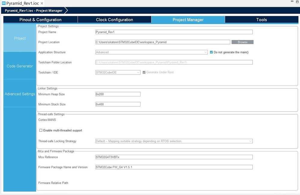

2022-10-31 2:07 AM
2022-10-31 4:27 AM
just i see: you checked -> NOT generate main.... better try: unchecked !
