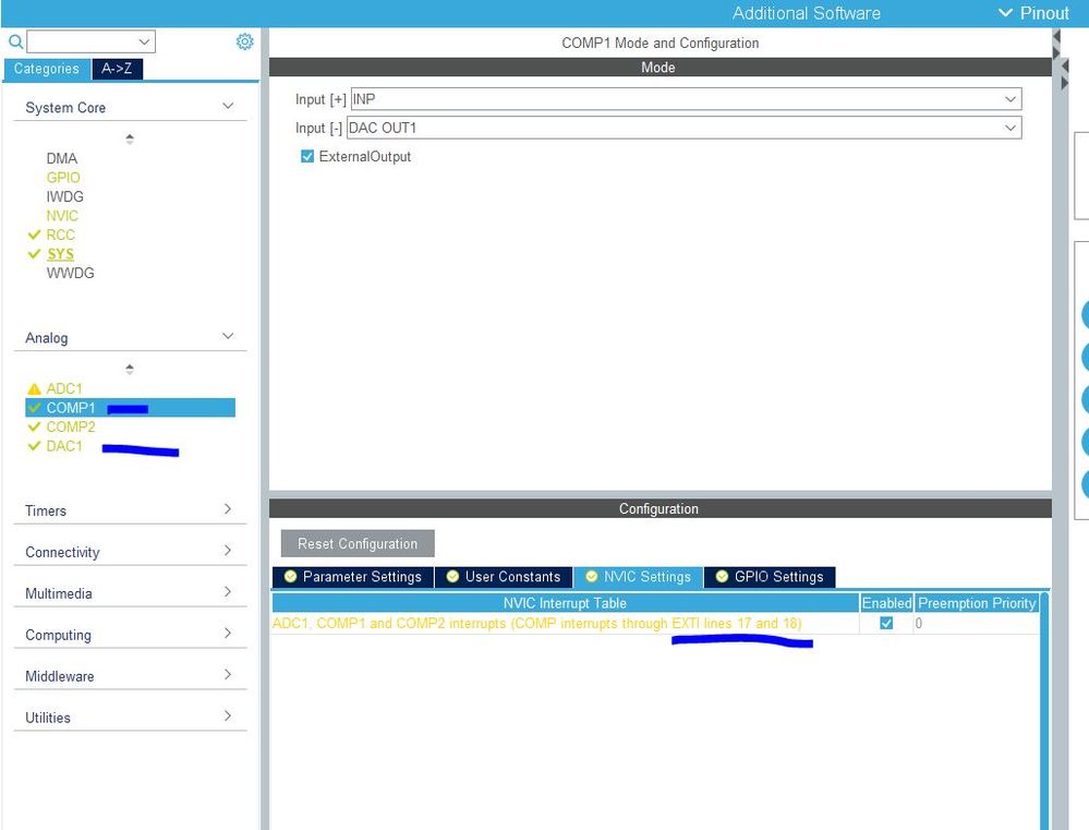

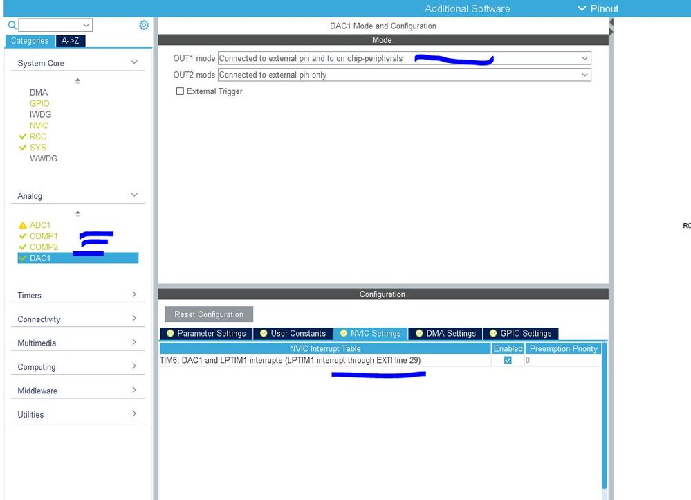

dac to comparator does not working interrupt
Ecift.1
0693W000000VzD8QAK.jpg0693W000000Vz0JQAS.jpgcomparator does not interrupt
This function handles TIM6, DAC1 and LPTIM1 interrupts (LPTIM1 interrupt through EXTI line 29).
LL_EXTI_LINE_17 ?
17 ? 29 ?
 @file      : main.c
LL_TIM_GenerateEvent_CC1(TIM6);
LL_EXTI_EnableIT_0_31(LL_EXTI_LINE_17);
LL_EXTI_EnableEvent_0_31(LL_EXTI_LINE_17);
@file      : main.c
 * @brief COMP1 Initialization Function
 * @param None
 * @retval None
static void MX_COMP1_Init(void)
 /* USER CODE BEGIN COMP1_Init 0 */
 /* USER CODE END COMP1_Init 0 */
 LL_COMP_InitTypeDef COMP_InitStruct = {0};
 LL_GPIO_InitTypeDef GPIO_InitStruct = {0};
 LL_IOP_GRP1_EnableClock(LL_IOP_GRP1_PERIPH_GPIOA);
 LL_IOP_GRP1_EnableClock(LL_IOP_GRP1_PERIPH_GPIOC);
 /**COMP1 GPIO Configuration
 PA6  ------> COMP1_OUT
 PC5  ------> COMP1_INP
 GPIO_InitStruct.Pin = LL_GPIO_PIN_6;
 GPIO_InitStruct.Mode = LL_GPIO_MODE_ALTERNATE;
 GPIO_InitStruct.Speed = LL_GPIO_SPEED_FREQ_VERY_HIGH;
 GPIO_InitStruct.OutputType = LL_GPIO_OUTPUT_PUSHPULL;
 GPIO_InitStruct.Pull = LL_GPIO_PULL_UP;
 GPIO_InitStruct.Alternate = LL_GPIO_AF_7;
 LL_GPIO_Init(GPIOA, &GPIO_InitStruct);
 GPIO_InitStruct.Pin = LL_GPIO_PIN_5;
 GPIO_InitStruct.Mode = LL_GPIO_MODE_ANALOG;
 GPIO_InitStruct.Pull = LL_GPIO_PULL_NO;
 LL_GPIO_Init(GPIOC, &GPIO_InitStruct);
 /* USER CODE BEGIN COMP1_Init 1 */
 /* USER CODE END COMP1_Init 1 */
 COMP_InitStruct.InputPlus = LL_COMP_INPUT_PLUS_IO1;
 COMP_InitStruct.InputMinus = LL_COMP_INPUT_MINUS_DAC1_CH1;
 COMP_InitStruct.InputHysteresis = LL_COMP_HYSTERESIS_NONE;
 COMP_InitStruct.OutputPolarity = LL_COMP_OUTPUTPOL_NONINVERTED;
 COMP_InitStruct.OutputBlankingSource = LL_COMP_BLANKINGSRC_NONE;
 LL_COMP_Init(COMP1, &COMP_InitStruct);
 LL_COMP_SetPowerMode(COMP1, LL_COMP_POWERMODE_HIGHSPEED);
 LL_COMP_SetCommonWindowMode(__LL_COMP_COMMON_INSTANCE(COMP1), LL_COMP_WINDOWMODE_DISABLE);
 LL_COMP_SetCommonWindowOutput(__LL_COMP_COMMON_INSTANCE(COMP1), LL_COMP_WINDOWOUTPUT_EACH_COMP);
 /* Wait loop initialization and execution */
 /* Note: Variable divided by 2 to compensate partially CPU processing cycles */
 __IO uint32_t wait_loop_index = 0;
 wait_loop_index = (LL_COMP_DELAY_VOLTAGE_SCALER_STAB_US * (SystemCoreClock / (1000000 * 2)));
 while(wait_loop_index != 0)
  wait_loop_index--;
 LL_EXTI_DisableEvent_0_31(LL_EXTI_LINE_17);
 LL_EXTI_DisableIT_0_31(LL_EXTI_LINE_17);
 /* USER CODE BEGIN COMP1_Init 2 */
 /* USER CODE END COMP1_Init 2 */
 @file  stm32g0xx_it.h
 * @brief This function handles TIM6, DAC1 and LPTIM1 interrupts (LPTIM1 interrupt through EXTI line 29).
void TIM6_DAC_LPTIM1_IRQHandler(void)
 /* USER CODE BEGIN TIM6_DAC_LPTIM1_IRQn 0 */
  if(LL_TIM_IsActiveFlag_CC1(TIM6)==1)
// LL_TIM_ClearFlag_UPDATE(TIM6);
  // LL_TIM_ClearFlag_CC1OVR(TIM6);
LL_TIM_ClearFlag_CC1(TIM6);
  /* LED toggling */
  LL_GPIO_TogglePin(LED_GPIO_Port, LED_Pin);
 /* USER CODE END TIM6_DAC_LPTIM1_IRQn 0 */
 /* USER CODE BEGIN TIM6_DAC_LPTIM1_IRQn 1 */
 /* USER CODE END TIM6_DAC_LPTIM1_IRQn 1 */
 * @brief This function handles ADC1, COMP1 and COMP2 interrupts (COMP interrupts through EXTI lines 17 and 18).
void ADC1_COMP_IRQHandler(void)
 /* USER CODE BEGIN ADC1_COMP_IRQn 0 */
/* LED toggling */
 /* USER CODE END ADC1_COMP_IRQn 0 */
 /* USER CODE BEGIN ADC1_COMP_IRQn 1 */
 /* USER CODE END ADC1_COMP_IRQn 1 */
