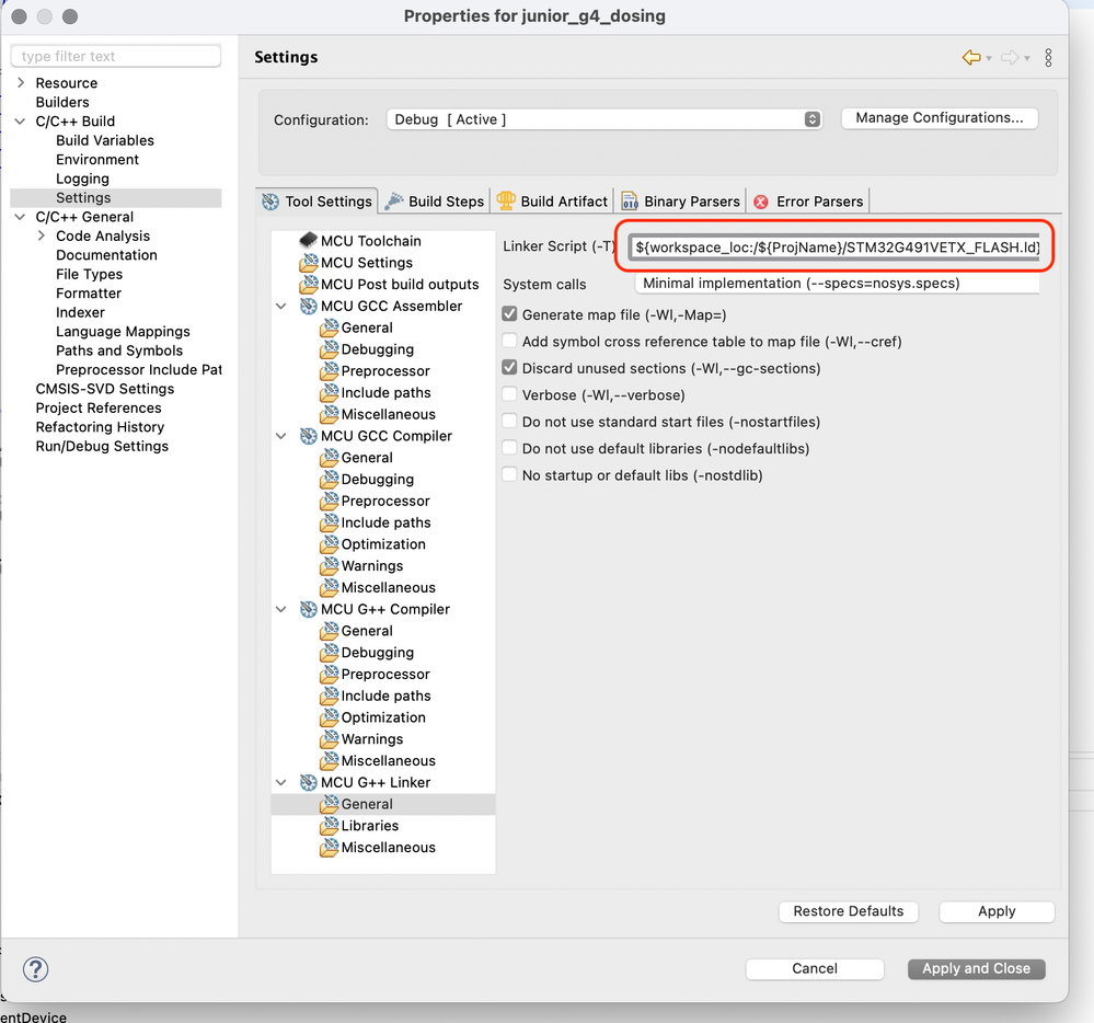

Custom Linker Script with CubeMX
Hi there,
I would like to customize the linker script generated by CubeMX.
Right now, any changes to the linker file get overwritten when I generate code from CubeMX.
Is there a way I can accomplish this? Thanks!
KnarfB
KnarfBBest answer
Aug 14, 2020 2:59 PM UTC
You can rename the generated .ld file and specify the new file name in the linker settings. The renamed file should not be touched anymore.

PMart.1
PMart.1Author
Aug 19, 2020 3:49 PM UTC
Thanks @KnarfB​  that did the trick.
Sid Price
Jun 29, 2021 5:11 PM UTC
I cannot get this solution to work for my project. I have renamed the linker script AND moved it to a different folder (Core) but CubeIDE still overwrites it when I generate code.
DSala.18
Sep 7, 2023 10:19 AM UTC
in case anyone still wondering:
it's here:
