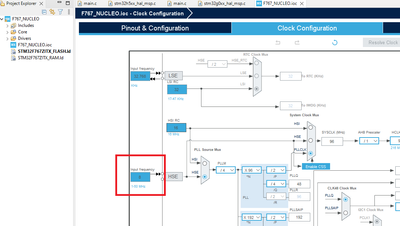

in the user manual "STM32 Nucleo-144 boards" is written that the HSE clock is linked to a 8 MHz oscillator. But when I enable the HSE clock in the .ioc file, the value is 25 MHz. I don't understand if the HSE clock is 8 MHz or 25 MHz.

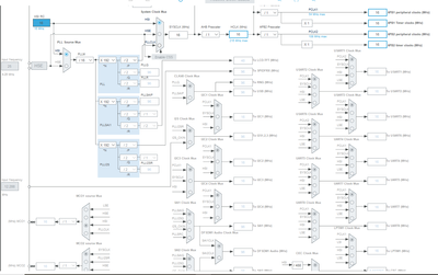

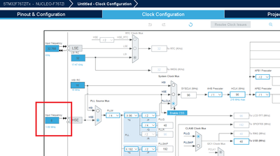

This is a screen shot of CubeMx starting a project from a board: NUCLEO-F767ZI.
Generated view starting a project from stand alone CubeMx:
Generated view from CubeIDE (integrated CubeMx):

This is the screen of CubeMX for NUCLEO-F767ZI. Maybe it is not visible, but the number for HSE is 25

In two manners, but the result was the same:
- I opened a new project with STM32CubeIDE by selecting NUCLEO-F767ZI as board
- I opened a new project with STM32CubeMX by selecting NUCLEO-F767ZI as board

What versions are you using?
The above screenshots I shared respectively:
CubeMx 6.12.1 (stand alone)
CubeIDE 1.15.1
‎2024-09-27 06:58 AM
CubeMX 6.6.1
CubeIDE 1.15.1

Your CubeMx has an old version.
For CubeIDE I didn't reproduce the behavior from my side, the clock is set at 8 as you can see from above.
Also from you screenshot you shared it doesn't seem to be generated from a board! but may be from the MCU part number.
