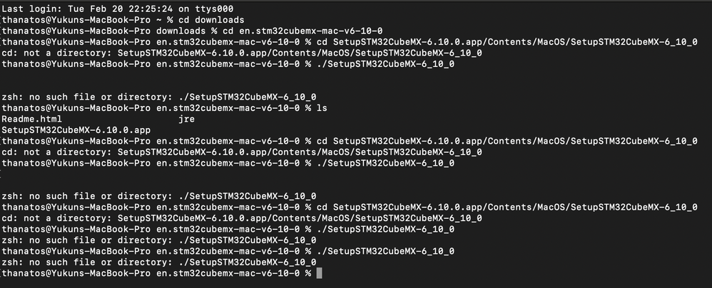

I got the same issue, and followed up your instruction, but I still get no luck. this is what I can show.
Please help.
Thank you

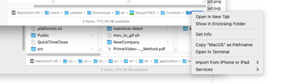

Thomas
Try to right click on the CubeMX setup icon/Show package content and then reach the final destination through finder. Once there, right click on the path shown below and click open in Terminal.
Thank you for the help, I solved the issue too.
