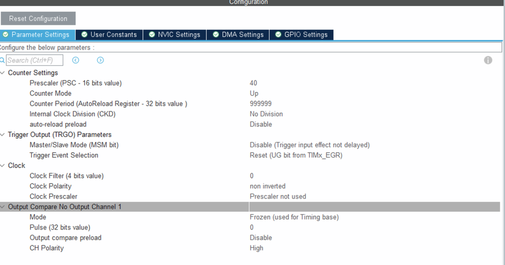

For Output Compare No Output Channel 1 I select "Frozen (Used for timing base)".

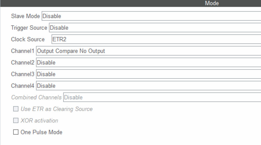

I discovered this when trying to use the TIM2_ETR pin as a source for the clock. The input clock is killed when the HAL libraries set CC1E.
Is this a bug in the cube or am I just getting the setting wrong?

it seems I have to replace
// HAL_TIM_OC_Start_IT(&htim2, TIM_CHANNEL_1); //HAL enable compare & interrupt
with
TIM2->DIER |= TIM_DIER_CC1IE; //enable counter
so it is just the HAL library, not so flexible.

‎2023-06-16 11:24 AM
I should have made it more clear, I have solved the problem.
The cube generates the correct code, but I added the line HAL_TIM_OC_Start_IT(&htim2, TIM_CHANNEL_1); into main() manually to enable the Output Compare interrupt. I did not realise that this line also enables the output.
