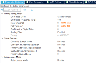

Every time I need to configure I2C, which is not often, I have to check the correct rise and fall times for the default 100kHz frequency and doing so I am asking myself a question why the typical 100kHz value is provided by default but rise and fall times are not, when most of the time 1000 and 300ns values are needed and I2C will NOT work with default values 0. Would not it increase user experience if the correct, typical values were provided in addition to the typical clock frequency?
Btw, CubeMX calculated timings are slightly off the I2C specs and conditions defined in ST RM docs. I believe the CubeMX algorithm is incorrect. Therefore I suggest to always enable the 'advanced settings' and allow the user to enter timings manually. Explaining why the calculation algorithm is incorrect is beyond the scope of this post.

@AScha.3 I usually check the actual rise/fall time, but why does it matter? You seem to be missing my point.
In a standard 100kHz mode max rise time for both SDA and SCL signals is 1000ns and max fall time is 300ns. Consequently, default CubeMX settings should accommodate for the maximum allowable rise/fall times. Of course, when the actual measurements are obtained fine tunning could be made, but why not to set those rise/fall times (and consequently SCLDEL/SDADEL) to safe values by default? If the actual times are shorter then max allowed, nothing bad would happen.
Current default rise/fall time values 0 (zero) are always incorrect.
Please e.g. refer to RM0456, Table 655. This table mentions SMBus, but timings apply to non-SMBus as well. See NXP document UM10204, table 10, p.48. and other I2C standard specs.
For the detailed discussion refer to RM0456 p. 2683-2685.
