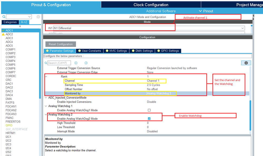

Hello LDoes.1,
STM32CubeMX has already this option, in fact, in order to select a watchdog (2 or 3) to monitor a channel (e.g., Analog watchdog 2 to monitor channel 1) :
  • Activate channel 1.
  • Enable Analog Watchdog2Mode.
  • Select "ADC_Regular_ConversionMode" >> "Rank", from "channel" list you can select the channel (from those already activated) and with “Monitored by�? you can choose the watchdog to monitor this channel.
You’ll find below a screenshot to clarify more the process (case channel 1 activated and Analog Watchdog2 enabled).

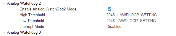

Hi Khouloud,
I am aware of the differences between AWD1 and AWD2&3 however my question/bug report is about the fact that CubeMX has no option to set the channels for AWD 2&3 (the thing that makes them more flexible).
Of course it is possible to set the register manually in software but in my opinion this defeats the purpose of using CubeMX
Hello LDoes.1,
BR,
Khouloud.
Hi Khouloud,
This is exactly what I was looking for, many thanks.
