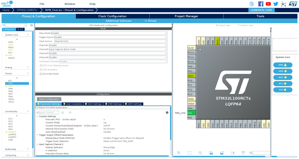

Input Capture with TIM2, Channel 2, Pin A1.

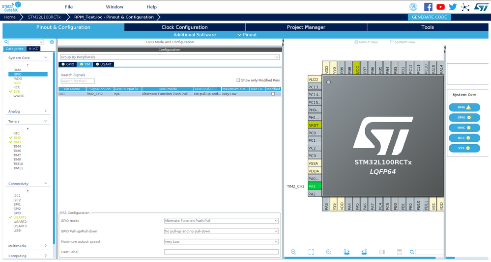

I've been working on a project where I have to measure frequency, so I setted up the Input Capture on Timer 2 as in the Picture:
After exporting the code, and implementing the functions as needed based on a tutorial I watched I didn't get any result out, nor any execution of the interrupt that should start at the capture event, what I noticed is that the GPIO pin is being declared as a alternate function push pull output instead of an input... is that ok?, you can watch that in this picture:

waclawek.jan
Yes.
When set as AF, the connected peripheral controls the actual direction of the pin, i.e. whether it's input or output.

Thank you very much for your answer, now I know the problem must reside somewhere else, I will post again in case I can't solve it by myself.
