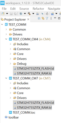

Hello everyone, I'm creating a TIM3-based project using CubeMX. I'm using the Nucleo-H755ZI development board, which features the STM32H755ZITx dual-core MCU.I've completed all the necessary configurations—GPIO settings, TIM settings, SYS, and PROJECT settings. However, when I click "Generate Code," it creates the main.c file but does not generate the xxx_FLASH.ld linker script file. My selected Toolchain is STM32CubeIDE. I'm using CubeMX version 6.15 and CubeIDE version 1.19.
Does anyone have any idea what might be causing this issue?

Further to your comment, I was not able to reproduce your request.
Could you provide please your Ioc.File.

MikeStrom
If you are on Linux (or MacOS on a case sensitive disk), you might have the same issue as i just reported here?
https://community.st.com/t5/stm32cubemx-mcus/wrong-file-name-for-linker-script/m-p/834008/thread-id/33307
LXIV
I have same problem. So, I updated 6.16.0, but still ld file wasn't generated. Did you fixed it?
