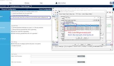

I always generate code in the Project Manager to use MKD-ARM V5.32 using "Copy Only the necessary library folder" option in the "Project Manager/Code Generator" tab, but this creates a lot of unecessary duplicated files.
Today I try the option "Add necessary library files as reference in the toolchain project configuration file", and the code does not compile, for "No such file or directory" error.
My user in this computer is "Cristhian Guedes", with a space between the words, and the CubeMX is generating links to Include folders using "CristhianGuedes" directories.
For exemple, the include path is generated:
"C:/Users/CristhianGuedes/STM32Cube/Repository/STM32Cube_FW_L0_V1.12.2/Drivers/CMSIS/Include"
but it must be with a space.
"C:/Users/Cristhian Guedes/STM32Cube/Repository/STM32Cube_FW_L0_V1.12.2/Drivers/CMSIS/Include"
All the rest is OK. After i manually changed the path to include this space, the generated code works ok (I take a "little" time to find that this is the problem, because I never have this kind of problem in CubeMX).
I put one image in the attachments.
Everytime I regenerate the code, it was regenerated without the space, forcing the user to change every path to its correct location manually.
Space and _funny characters_ in project paths are a proven recipe for troubles. This is fortunately easy to fix.
Open administrator command window and go to c:\users. Then make a symbolic link named CristhianGuedes that points to "c:\users\Cristhian Guedes"
mklink /d CristhianGuedes "c:\users\Cristhian Guedes"

just : can you leave away all non "character" symbols in any path , related to ...what you want ?
(space, + , € ...)
I dont know why, but there is a basic problem with this in the Eclipse/Java universe....
It will not work.
So setup / install everything, also your project name, without "spaces" etc. , then try again.
(No other solution , now .)

Thank you, it works as expected.
But I still think that if CubeMX allow the installation of repositories in this directorie "C:/Users/Cristhian Guedes/STM32Cube/Repository", so it must at least warn the user about it, and not install in one place, and link to another.
The workaround of @Pavel A. works to me.
But I need to question: if it not wil work using repositories in a path with SPACE, why CubeMX uses this path with space to put downloaded files in repositorie?
Why CubeMX does not automatic warns the user that the original localtion "C:/Users/Cristhian Guedes/STM32Cube/Repository" is invalid, and install in the correct path "C:/Users/CristhianGuedes/STM32Cube/Repository"?
Or allow the user to choose anoter location for it?
