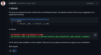

Refer to HERE for the solution.
#if defined (__GNUC__) && !defined (__CC_ARM) && !(defined(__ARMCC_VERSION) && (__ARMCC_VERSION >= 6010050))
