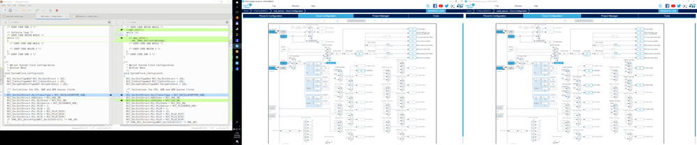

Hi All,
I recently updated the Codegenerator and now USB does not work on my STM32L468RG.
I made a concept of proof that worked and investigated the changes.
Icould see that in my complete Project the codegenerator initializes the RCC by HSI where it should use HSE.
When I change that it seems to work.
I post here the screenshot of my clockconfigurations of the projects as well as generated code snippet.
Please ST fix this bug ASAP.
regards, Adib.

usb_test.ioc is the small ioc that works
sam2_app.ioc is the more complete one that fails and creates an "HSI" instead HSE
