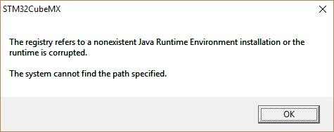

Continuing to the original problem, I've clean installed Java and Cube, after removing all previous installations. Now I'm getting the following error. I guess a bundled version might help, as Jan noted.
''java -version'' runs normally on the command prompt, so Java and its environmental variables should be correct.
Posted on May 22, 2017 at 14:41
Fixed that error and now I'm still getting the older error (the same as the one generating the log file).
