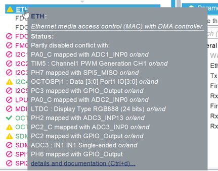

2)     If I generate with MX a basic configuration, even disabling all hardware peripherals, the tool keeps nagging “partly disable conflict with�? even with peripheral ADC I disabled.
Q2: How should I understand conflicts between 2 hardware parts where 1 is disabled? For the moment it seems a contradiction to me.

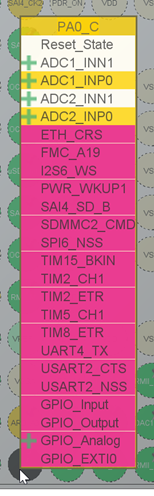

3)     If I try to correct beforementioned conflicts, I the tool is unwilling to let me change configuration: (Eth CHR, red, cannot be selected for PA0_C, so how to correct the alleged conflict? (right click on BGA pin PAO_C => ETH_CRS unselectable, remains red! even with other peripherials disabled.)
0693W00000NsERQQA3.pngQ3: How can I change PA0_C so it is connected with ETH_CRS to solve (if needed) the before mentioned conflict.

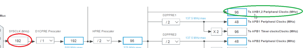

-        GDB SWD activated, Core clock 192MHZ (=SYSCLCK) and max SWO clock set at 2000.

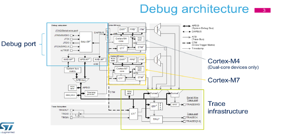

Thanks for the tip, I found a document https://www.st.com/content/ccc/resource/training/technical/product_training/group0/8a/bf/62/da/24/f0/49/7b/STM32H7-System-Debug_DBG/files/STM32H7-System-Debug_DBG.pdf/_jcr_content/translations/en.STM32H7-System-Debug_DBG.pdf where debugging STM32H7 is presented. There I saw (see below) AHB-AP used to link the Jtag/Serial wire port. So based on your info I used 96 and not the 192. And it worked. I do not know if my analysis is correct but with 96 SWD works so thanks a lot!

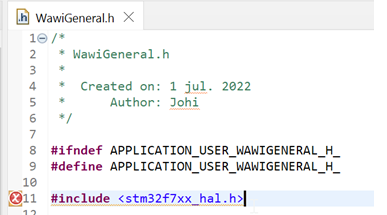

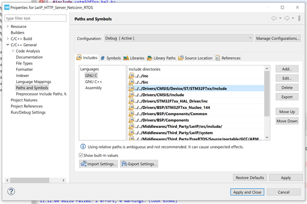

I loaded the Lw_IP_HTTP_server and am trying to expand it.
- added C++ capabilities (menu option new ... )
- added Wawi.cpp file
- Wawi.cpp includes WawiGeneral.h
0693W00000QKJm8QAH.png- WawiGeneral.h includes stm32f7xx_hal.h
=> ../Application/User/WawiGeneral.h:11:10: fatal error: stm32f7xx_hal.h: No such file or directory
Paths and symbols should be ok? (IMHO)

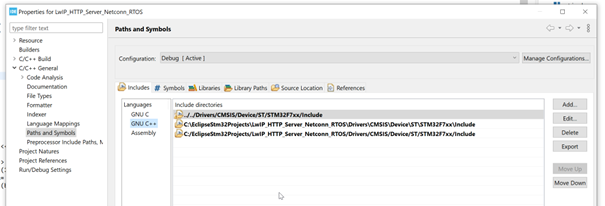

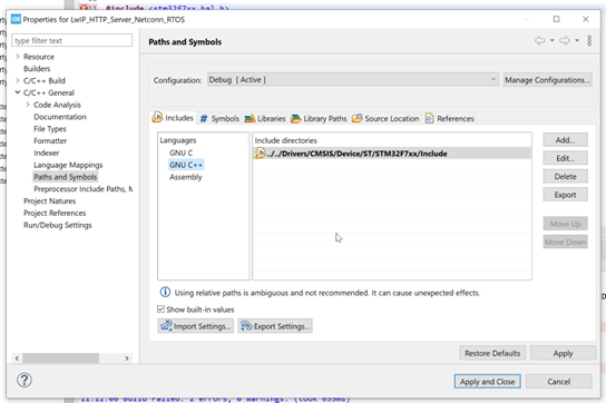

0693W00000QKJmXQAX.png+ apply & close.
That is a copy from the C settings:
0693W00000QKJmEQAX.pngFile exist in the forementioned directory:
0693W00000QKJmcQAH.pngI also tried to add the absolute path:
0693W00000QKJmmQAH.png=> Same problem.
What am I not seeing here?
