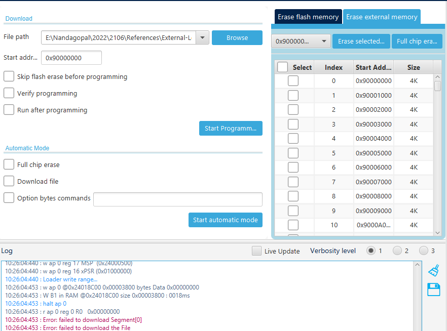

I created the External Loader after seeing successful implementation of Sector Erase, Write and Memory mapped Mode in my Cube IDE Project

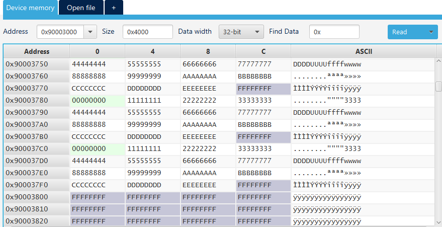

Cube Programmer (v.2.10.0) returns this when trying to program the Flash with a Binary File:
0693W00000Kd6fIQAR.pngAn Interesting thing is that The file does get written till Address 0x900037FF but it fails afterwards as shown here:
I have tried using older versions of Cube Programmer ( 2.8.0 and 2.7.0) but still the same result.

Attaching the Cube Programmer Log ( Verbose Level 3 ) in case it helps

If you erase and program repeatedly, does the "good" part (i.e. till 0x900037F0) always extend *precisely* to 0x900037F0? And, do you program in full page size (most commonly 256 bytes) chunks?

I checked the data in the Memory Monitor to double check and it was correct as shown.
I even tried writing a Buffer that was bigger so that it crosses the address 0x90003800 and it still worked.

Hi Andreas, Thank you so much for your time. I have edited my original post. The final Address that is written is 0x900037FF(Not 0x900037F0) And Yes it always extends precisely to this Address.
The Write Memory Function that I have implemented uses the QUAD IN PAGE PROGRAM operation that programs 256 bytes per operation
Also please note that I wrote a program to write data from a Buffer big enough to Exceed 0x900037FF and it was successful. Its the External Loader when used with Cube Programmer (and Cube IDE) that is causing the issue.

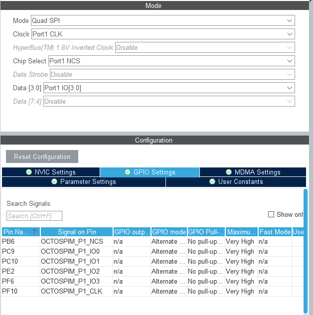

What pins are you using for the OCTOSPI1/QSPI interfacing?
https://www.issi.com/WW/pdf/25LP-WP064D.pdf
Hi Tesla, Thank you for looking into the Error Log.
Here are the pin configurations for the OSPI Peripheral interface with the Quad SPI Flash.

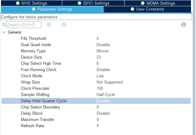

0693W00000KdLbQQAV.pngAlso attaching the OSPI Parameters that I have used.
