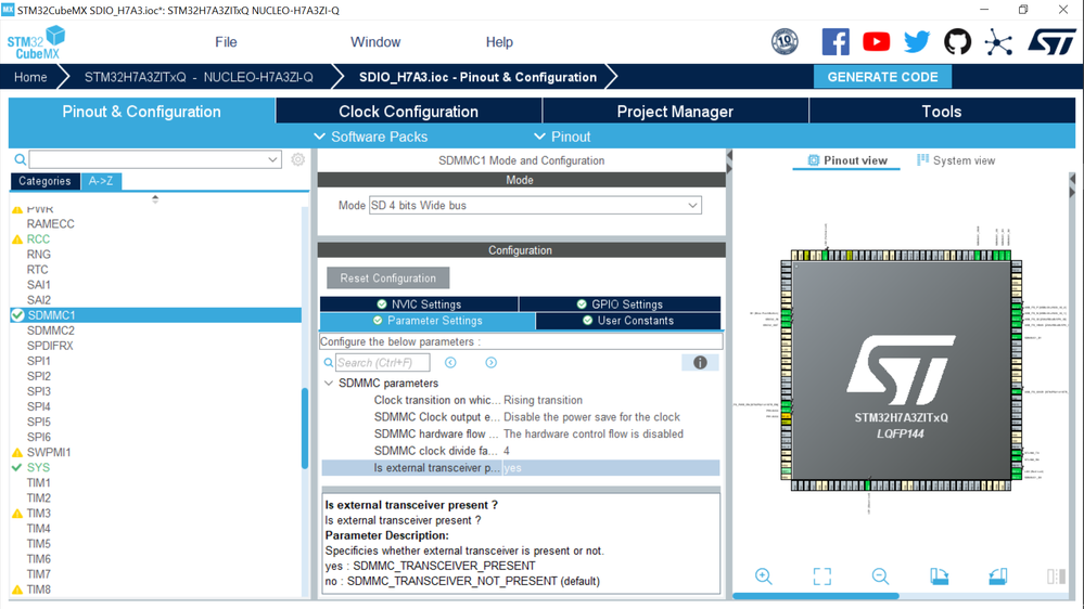

I am trying to connect to the WFM200 wifi module over SDIO. I am using the SDMM peripheral library/code for this.
However, in the selection in CubeMX there is only the options for SD and MMC but no SDIO.
Which option should I choose for using SDIO with the WFM200?
FBL
Hello @Hueli.1​,
Here is an example to configure SDIO. You may need to increase the SDIOCLK divide factor if getting FR_DISK_ERROR
_legacyfs_online_stmicro_images_0693W00000bi2xBQAQ.pngHope this helps!

FBL
Hello @Hueli.1​,
Best regards,
FBL

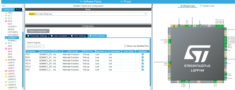

Hueli.1
thank you for the answer.
I now went with low gpio speed also to reduce noise in the signal since I am using a nucleo allowing only speeds up to ca 400kHz without distorision:
