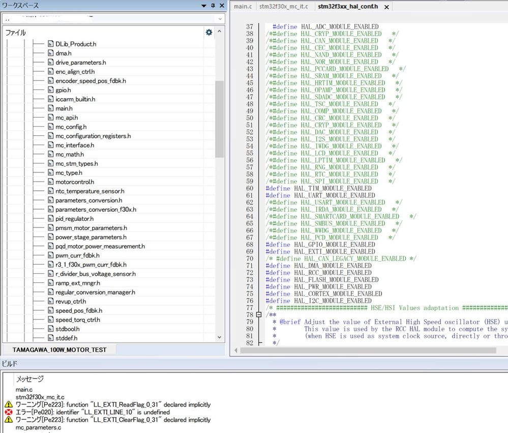

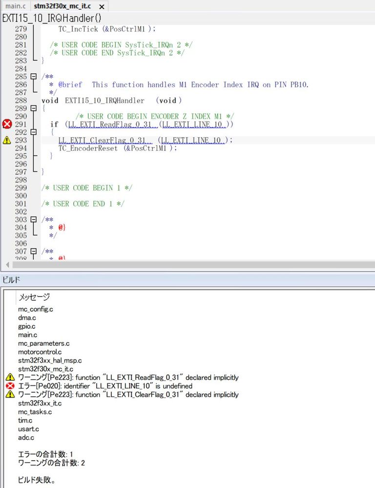

0693W00000aHcAlQAK.jpgIn order to control the position of the motor with x-cube-mcsdk, I set the Z phase (absolute) of the encoder.
However, I got a compilation error as shown in the attached image.
Please teach me how to fix the F/W.
The version of each tool is as follows.
x-cube-mcsdk ver.6.1.0
stm32cubemx ver.6.7.0
stm32cube_fw_f3 ver.1.11.3
IAR ewarm ver.9.30.1
Thank you.

So likely a missing include file for the low-level functions you're using.
Check stm32f3xx_hal_conf.h or other places files are selected for inclusion.
Sleep
Thank you.
-->I checked as shown below.
I have EXTI enabled, so I'm assuming this file is fine. is there a problem?
-->Could you tell me which file is suspect?
Thank you.
