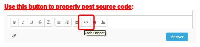

0693W000008xsqBQAQ.pngAlso, once your question is resolved:
