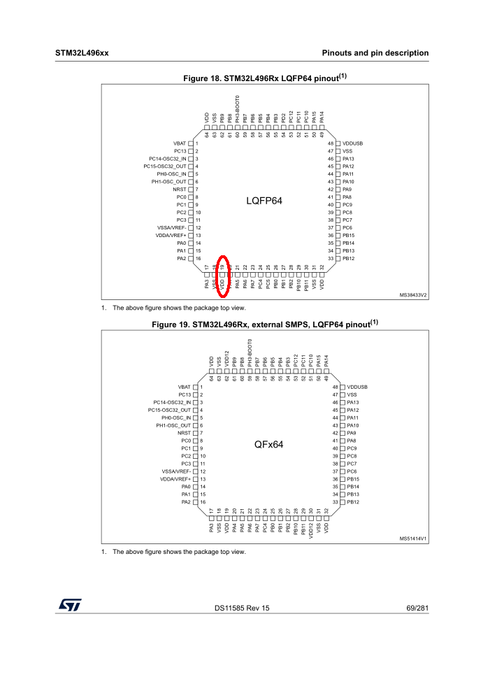

We configure the Vbuff as you shared configuration deatils,but 2.5 voltage is not generated on vref Pin 12 and 14 pin (VREF-) of STM32L496RETB are shorted .so is it Pin 13 and 19 pin (VREF+) of STM32L496RETB are shorted internally ???
GwenoleB
What Nucleo board do you use?
On STM32L496RET device, the VREF+ pin is double bonded with VDDA, that means the internal voltage reference buffer is not available.
Regards,
Gwénolé
On STM32L496RET device,there is VREF+ pin at 19 of MCU is we externally connected to 3.3v .But adc is not working properly. AS we connect external vref at 13 of MCU to 3.3v then adc is working properly.what is the difference between vref+ at 13 and 19 of MCU
waclawek.jan
No there is not. VDD is on pin 19.
0693W00000NsS4aQAF.pngJW
ok.
