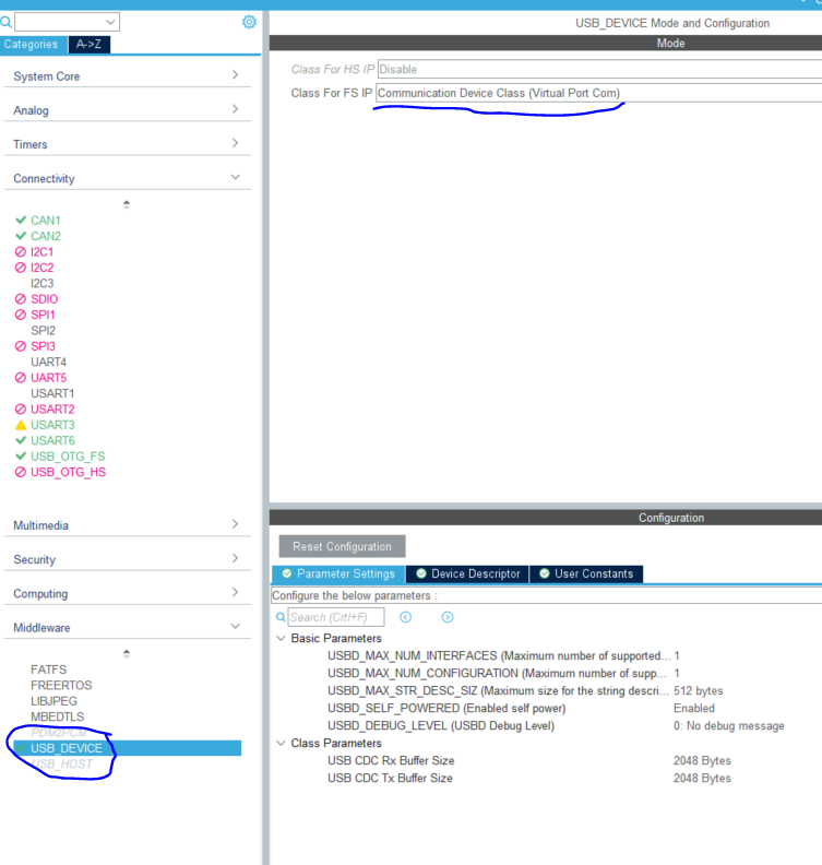

Hello everyone and i hope youre having a great embedded morning.
CDC_Transmit_FS() bricks itself when i check status of the ongoing transmission
is there any mechanism to know when a CDC_Transmit_FS transaction is finished?
When i try to CDC_Transmit_FS before the previous CDC_Transmit_FS is done retval=USBD_BUSY which is to be expected, well after that CDC_Transmit_FS doesnt work anymore always returning USBD_BUSY.
This code bricks the usb peripheral and can only be used again after system reset:
do {
//HAL_Delay(100);
retval=CDC_Transmit_FS(&buffer, receivedbytes);
} while (retval!=USBD_OK);//
retval=CDC_Transmit_FS("finished transmission", sizeof("finished transmission"));//this will return HAL_OK but no transaction will be done
If i place a dirty delay big enough for the first transaction to be done everything works.
HAL_Delay(1000);
im using STM32f205ret6
CubeMX Version 6.1.1

Hi @Ons KOOLI​ , thanks for your reply.
Yes i looked in those examples but i could only find examples for USB cdc host mode
C:\Users\myuser\STM32Cube\Repository\STM32Cube_FW_F2_V1.9.2\Projects\STM322xG_EVAL\Applications\USB_Host\CDC_Standalone\
Im using usb cdc device mode and the issue is my CDC_Transmit_FS blocks the preipheral/process when you check the status of the ongoing transaction.
All other examples and youtube videos ive seen everyone is just sending very small bursts of data, not minding if the previous transmission is over yet.
I trying to send 64kB bursts of data , so the time it takes to finish the tx is very important to me.

@Ons KOOLI​ thanks for your help but I have been taking a long look to the example you pointed to, and im even more confused than before.
Their CDC generated code has a completely different structure, there is not CDC_Transmit_FS() because usbd_cdc_if.c is not there.
I see your example uses USBD_CDC_TransmitPacket() to check if the transmission is completed?
void HAL_TIM_PeriodElapsedCallback(TIM_HandleTypeDef *htim)
  uint32_t buffptr;
  uint32_t buffsize;
  if(UserTxBufPtrOut != UserTxBufPtrIn)
    if(UserTxBufPtrOut > UserTxBufPtrIn) /* Rollback */
      buffsize = APP_TX_DATA_SIZE - UserTxBufPtrOut;
    else
      buffsize = UserTxBufPtrIn - UserTxBufPtrOut;
    buffptr = UserTxBufPtrOut;
    USBD_CDC_SetTxBuffer(&USBD_Device, (uint8_t*)&UserTxBuffer[buffptr], buffsize);
    if(USBD_CDC_TransmitPacket(&USBD_Device) == USBD_OK)
      UserTxBufPtrOut += buffsize;
      if (UserTxBufPtrOut == APP_RX_DATA_SIZE)
        UserTxBufPtrOut = 0;
USBD_CDC_TransmitPacket() also can be found inside my CDC_Transmit_FS()
uint8_t CDC_Transmit_FS(uint8_t* Buf, uint16_t Len)
  uint8_t result = USBD_OK;
  /* USER CODE BEGIN 7 */
  USBD_CDC_HandleTypeDef *hcdc = (USBD_CDC_HandleTypeDef*)hUsbDeviceFS.pClassData;
  if (hcdc->TxState != 0){
    return USBD_BUSY;
  USBD_CDC_SetTxBuffer(&hUsbDeviceFS, Buf, Len);
  result = USBD_CDC_TransmitPacket(&hUsbDeviceFS);///<-----Here
  /* USER CODE END 7 */
  return result;
So ill try to use it instead of the glitchy CDC_Transmit_FS().....
